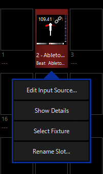

Ableton Link Options
- To edit a Ableton Link Input, right-click on or hold and select the Ableton Link Input.
Select
From the menu below, you can change of the properties of the Ableton Link.
