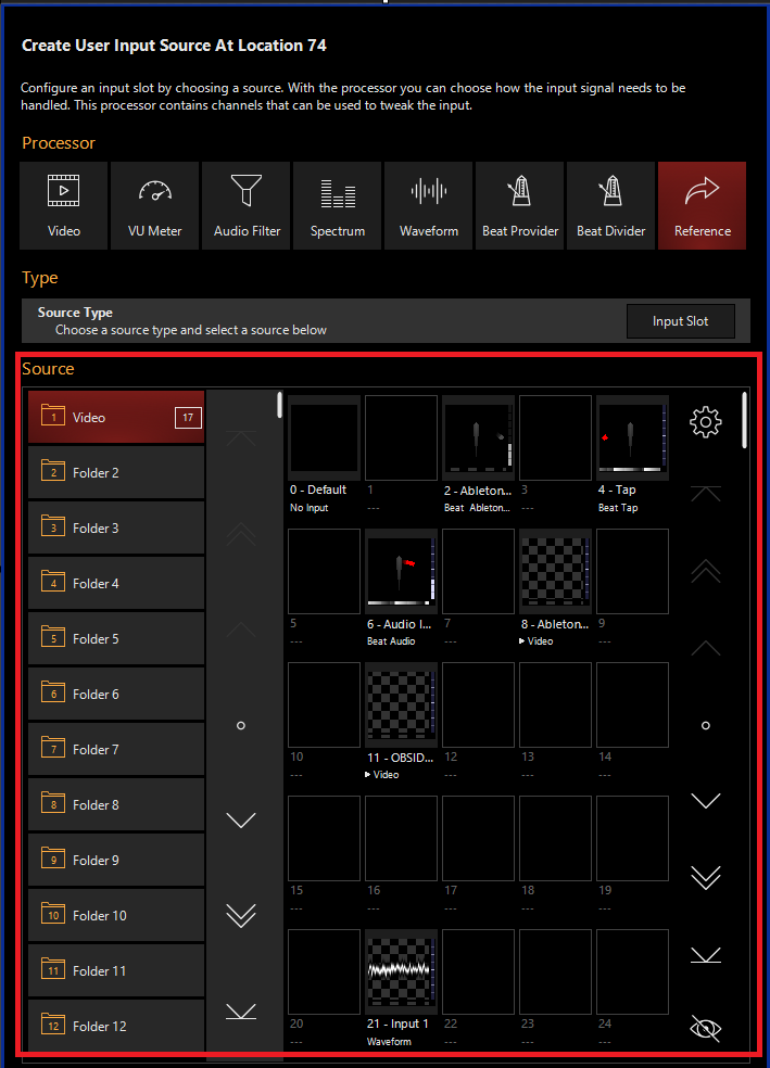

  1. Navigate to the Library view, button 5, on the default sidebar of the "Compose" workspace.
  2. Select the Input Source Tab at the bottom of the window:
  3. All slots will be blank if you're starting from scratch. To create one, Right-click or hold EDIT and press an empty slot.
  4. Select Create Input Source...
  5.  Select Reference under Processor.
  6. Select the desired Source Type
  7. Select a source.
  8. Press OK

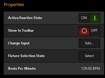

Editing a Reference Input Processor
  1. To edit a Reference Input Processor, right-click on or hold Edit and select an existing Reference Input Processor.
  2. Select Show Details
  3. From the menu below, you can change the properties of the Reference Input Processor.
Table of Controls
Control Description
Properties
Active/Inactive State: Toggles the state of the Input between Active and Inactive.
Change Input: Used to select a different source input for this Input.
Fixture Selection State: Select the Input as a fixture for making changes using the Channel visualizer (CV)
Beats Per Minute: Shows the current detected or operating BPM
This Selects if the changes should be made to the default properties of the Input or put into the programmer like if editing a fixture.
Defaults: Used for changing the default state of the Input
Programmer: Used for temporary changes recorded into a cue.
