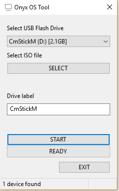

1. Insert your USB Flash Drive (min 16 GB)
2. Start the ONYX OS Tool
3. Select the USB Drive. Be careful not to select the wrong drive letter (sd card, external hard drive), this tool will format it completely.
4. Select the ONYX ISO file
5. Click "Create OS"
6. The tool will erase the stick and prepare it for use with ONYX Consoles.

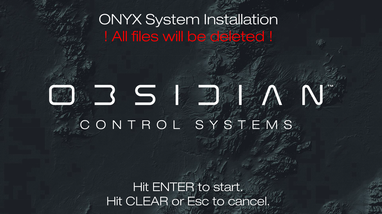

After booting from the USB drive the console will show this screen. Press to start the installation.
The system will now copy all the installation files to your console, expand and install them. This can take a few minutes.

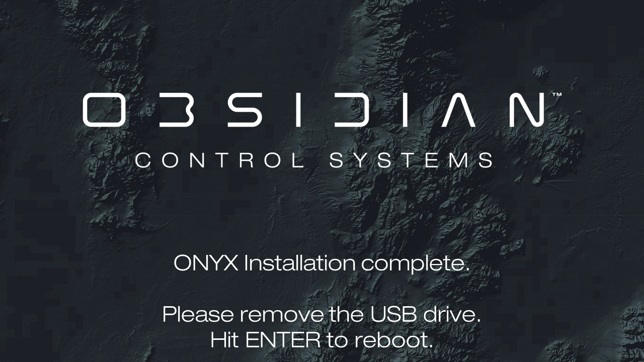

The Console will now ask to restart. Remove the recovery stick and press “Reboot” to continue. The desk will installs all files and drivers and may reboot several times. It is completed once the Obsidian ONYX Load Show screen appears

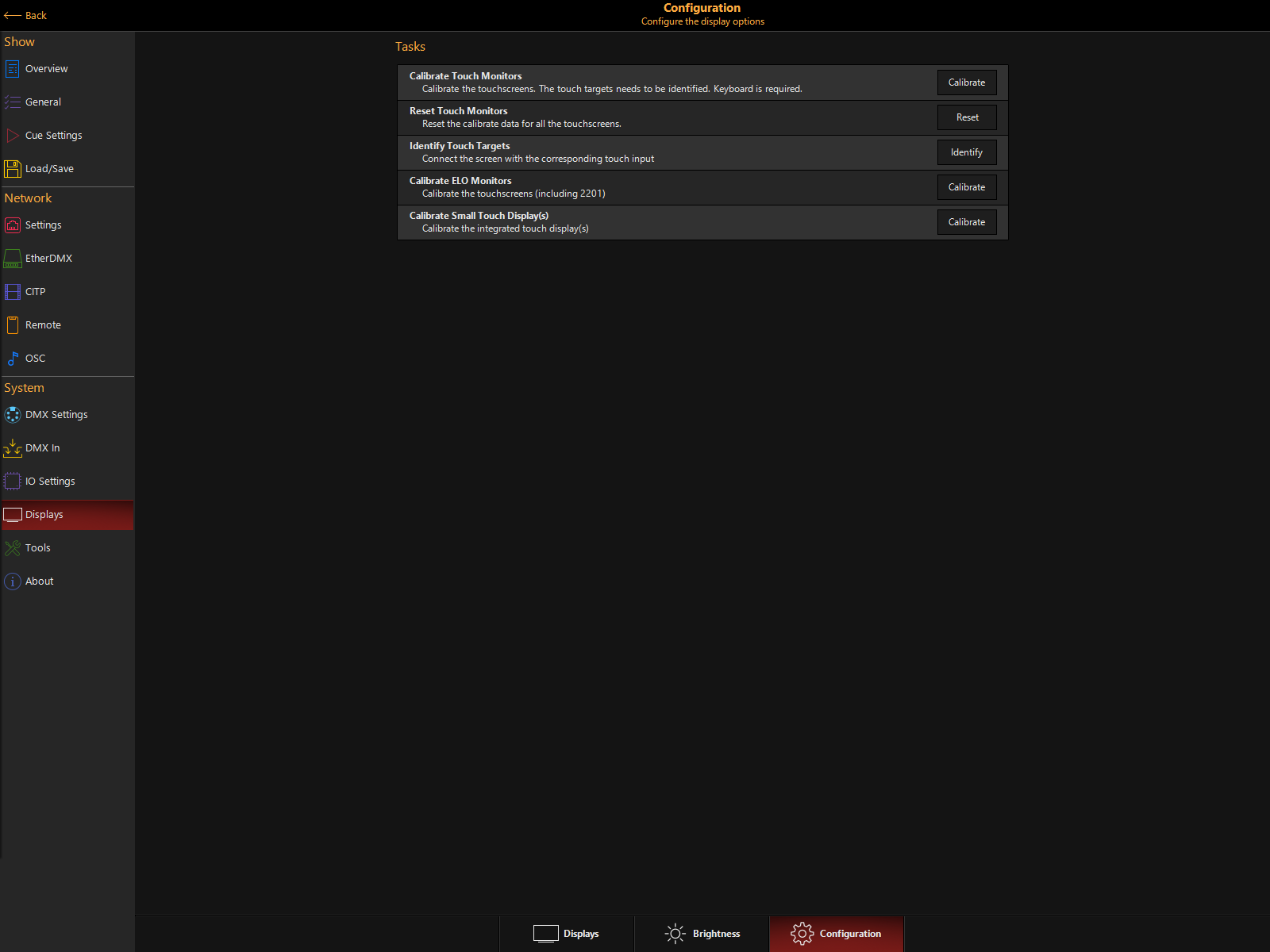

If needed, the internal display of the Console can be calibrated using a tool in the software. Go to Menu > Displays > Configuration and select the Screen tab.
Press the “Calibrate…” button to continue.

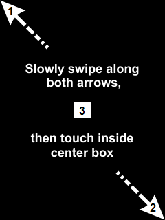

Now look at the integrated display and slowly swipe along both arrows with your index finger. Then touch inside the white center box. Calibration is now executed and you can continue using the console.
