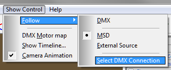

To select the 'Art-Net DMX Node (No Transmit)' connection, start the MSD 3D Visualizer module and select 'Select DMX Connection' from the 'Show Control – Follow' menu.
A dialog will open where you see all the available MSD Connections, which you installed during the MSD installation process. Select 'Art-Net DMX Node (No Transmit)' and press the 'Select' button.

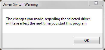

Now press the 'OK' button to finalize your selection. A dialog will pop-up with the following warning:
You will have to close down and restart the program to re-initialize the program with the correct connection.

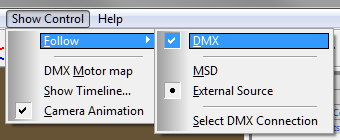

After restarting the program, make sure that the MSD Visualizer is using the external connection as its input source for DMX. (The other option being 'MSD' where another MSD module is used as input.)
You can also see which of these two is selected in the status bar of the program, in the bottom right. It should state 'Ext' in the right button for 'External Source'.
In this image, you can also see (in the red button) that the 'DMX in' option is currently disabled, so to enable DMX in, you have to select it in the 'Show Control – Follow' menu, by making sure the 'DMX' option is checked.
This will change button in the status bar to 'DMX ON' and the color will change to orange, meaning DMX is ready to receive data.
