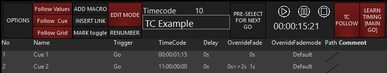

Timecode Cuelist Header
You will note several buttons available in "Cuelist Values" for the Timecode Cuelist:
| Button | Description |
| 00:00:00:00 | This is where the received timecode is displayed. The format is HH:MM:SS:FF. HH is hours, MM is minutes, SS is seconds and FF is frames. |
The Play button is used to start SMPTE when using the internal timecode generator. |
The Pause button is used to stop the internal timecode generator without resetting it to zero. To resume, press the Play button. |
The stop button is used to stop the internal timecode generator. Pressing this button will cause the clock to reset to 00:00:00:00 |
When set to on, the Cuelist will “listen” to the selected timecode generator and the Cuelist will follow the timecode. When turned off, incoming timecode will be ignored. If turned on while timecode is running, the Cuelist will advance to the last executed cue as determined by the timecode value. |
When selected and a timecode source is present, pressing the console's button will automatically capture the timecode time that the cue was executed and save it with the cue for later playback. Pressing on the Cuelists Go button will simply advance the Cuelist without capturing the timecode time. This is useful if you want some cues to follow timecode, but some cues to be triggered manually. |
