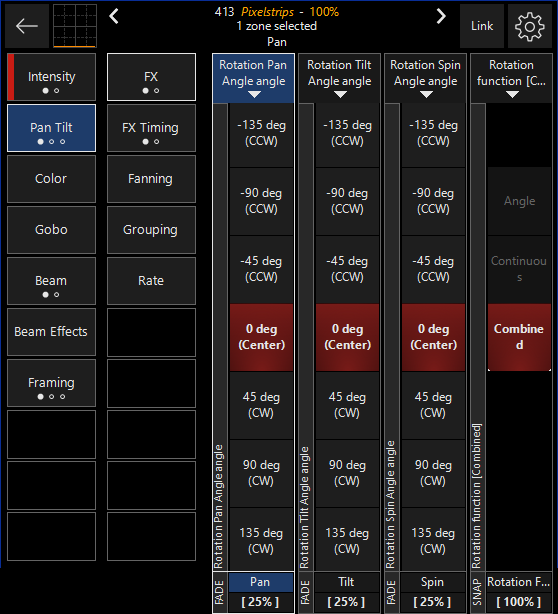

By using the parameter controls, we can use the parameter group to move the entire canvas of any of the Zone slots with that 3D space by modifying the Rotation, Position, and Size attributes:
