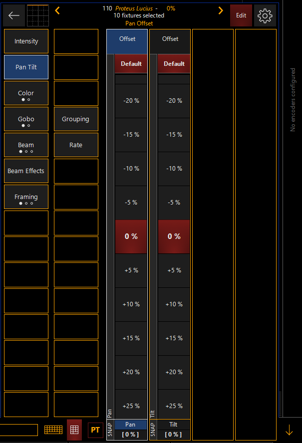

Applying an Offset to a Fixture Parameter

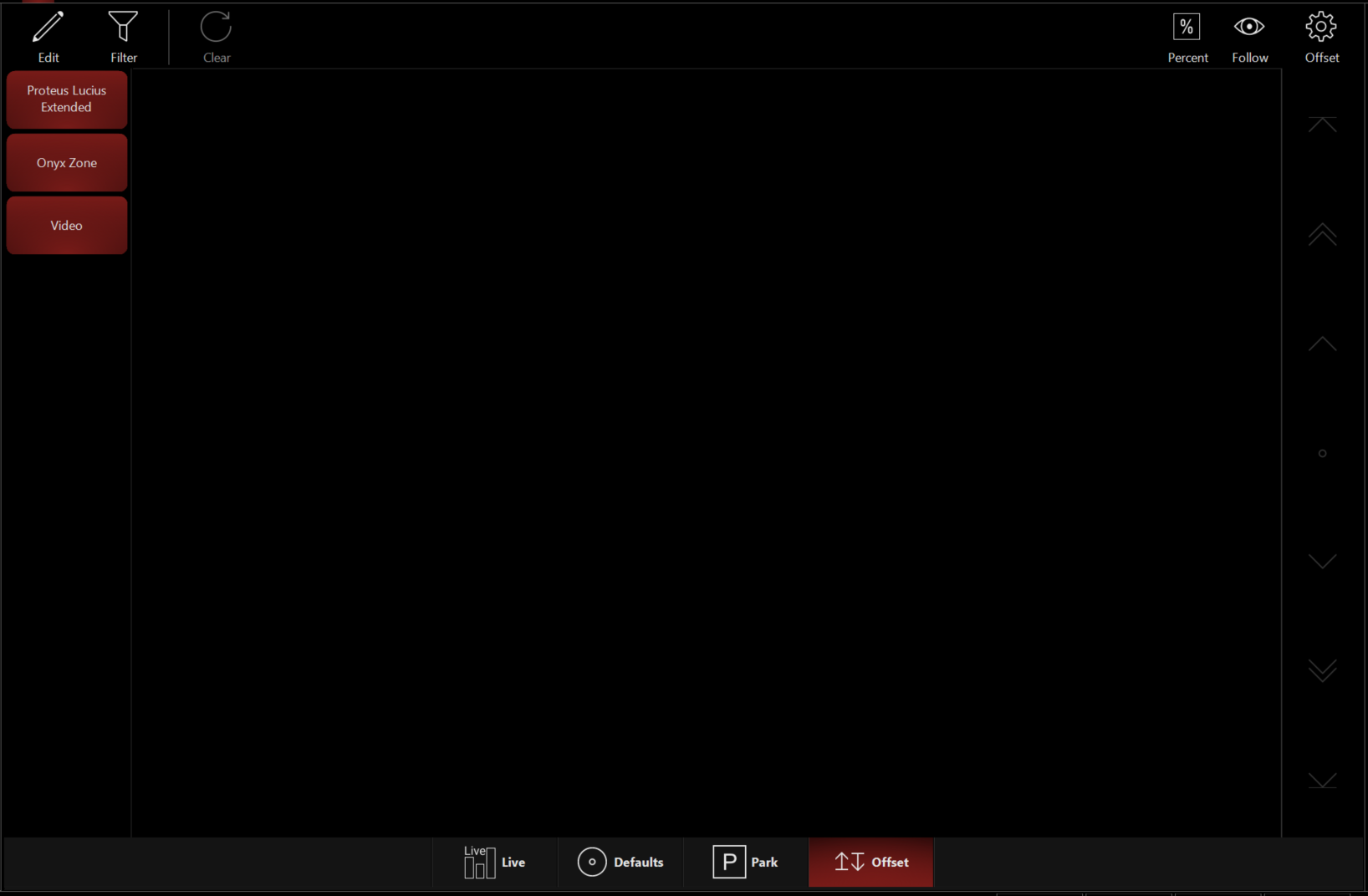

- Open the Offsets window (Located by default in the Output Center view 11)
- Press  in the upper left
- Select the fixtures that you wish to modify
- Change the fixture parameters into the new desired offset value using the CV (channel visualizer)
- Press  in the offset window to exit.

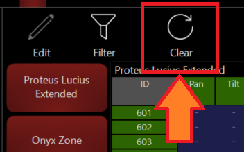

- Press Clear in the Offset window

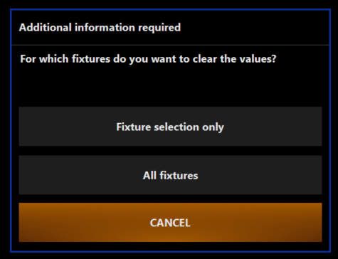

- Select if you want to clear  or
