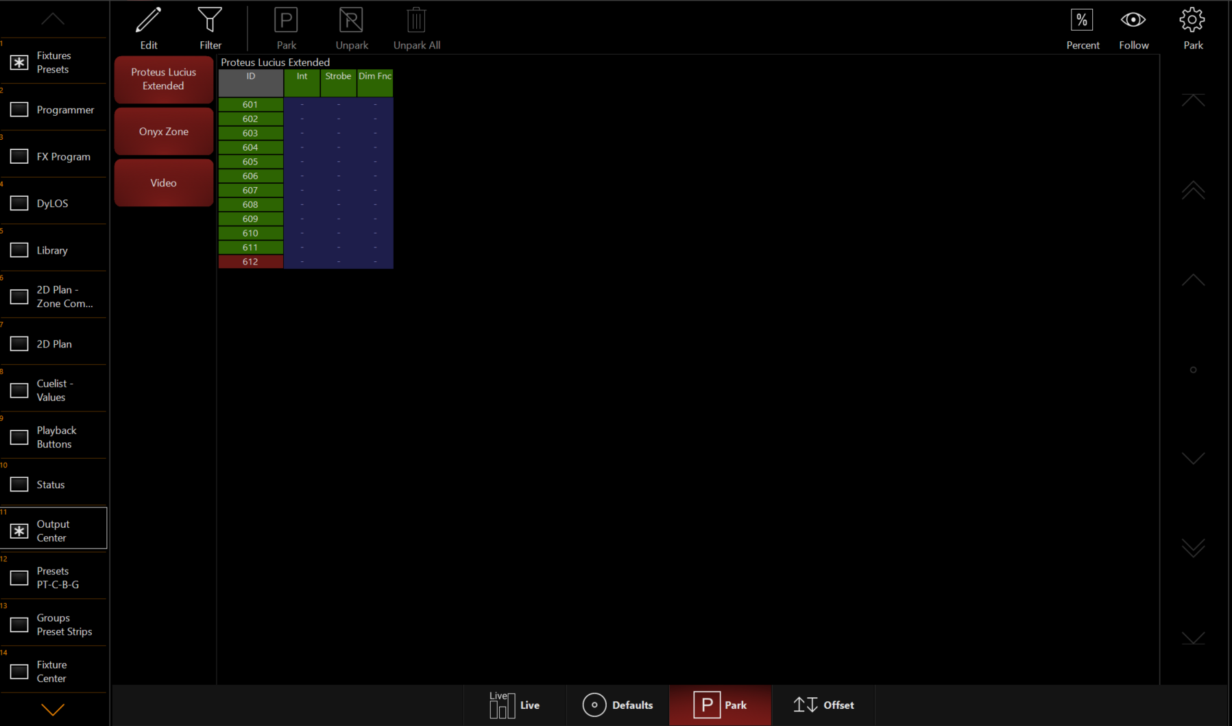

- Open the Park window (Located by default in the Output Center view 11)
- Press  in the upper left
- Select the fixtures that you wish to modify
- Change the fixture parameters into the desired Parked value using the CV (channel visualizer)
- Press  in the Park window to exit.

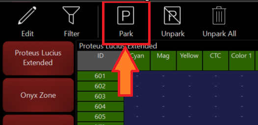

- Select the fixtures that you wish to park
- Press

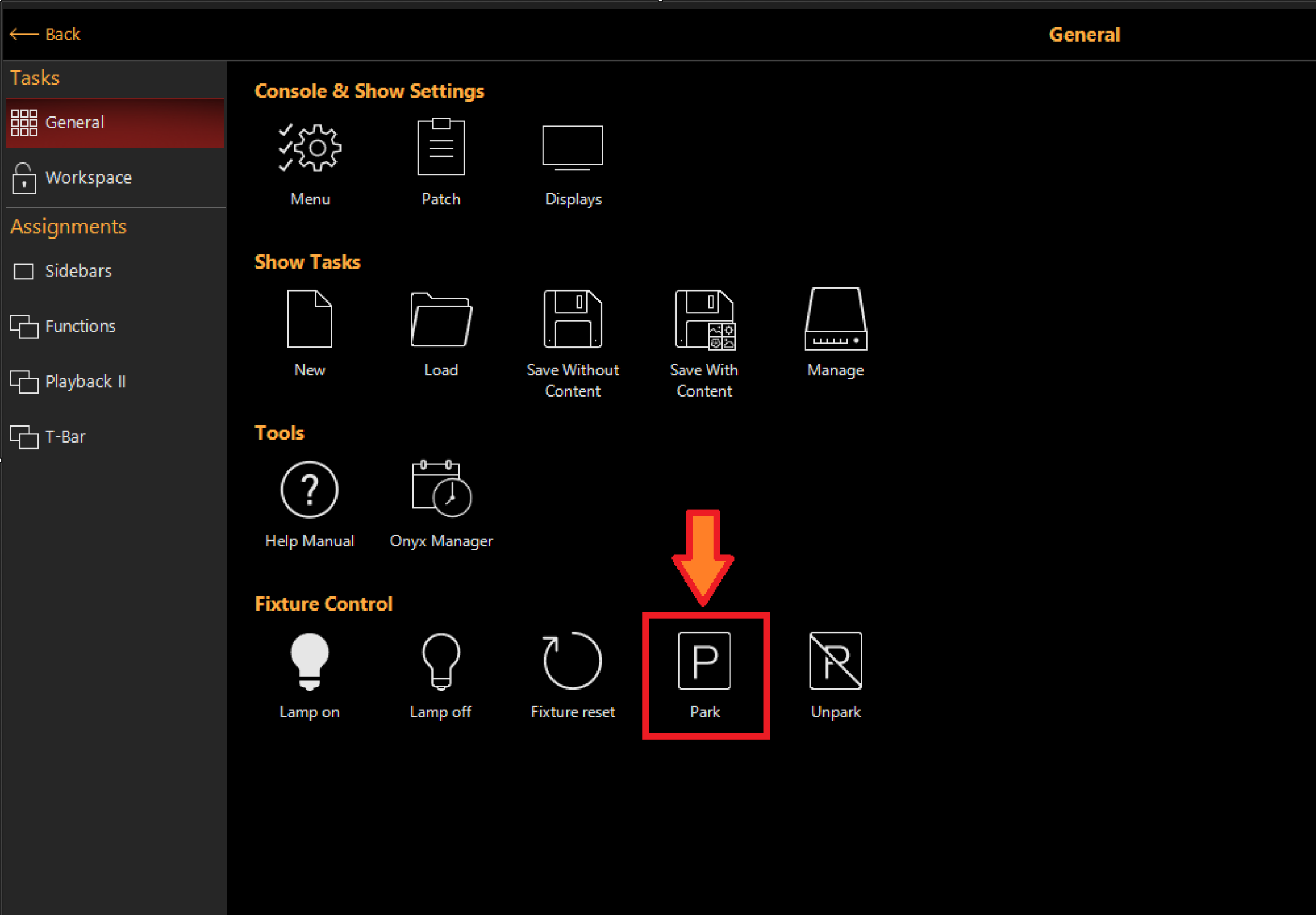

- Select the fixture you wish to park

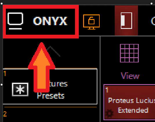

- Open the Quick Menu (Onyx Logo in the upper left)
- Press
- Hold  and press the fixture parameters in the CV (channel visualizer), you can also right click the parameter and press  if on PC.

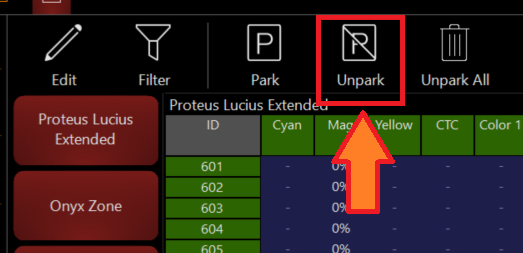

- Select the fixtures that you wish to unpark
- Press
- Press in the Park window to confirm and Unpark the selected fixture.

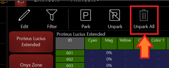

Unparking All Fixtures
- Press
- Press  in the park window to exit.
