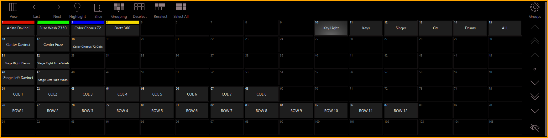

Inside of any window with scrolling there is also a touch point which allows you to press the center circle and activate a variable scroll. This is especially helpful on large shows!
Take, for example, the "Groups" window:

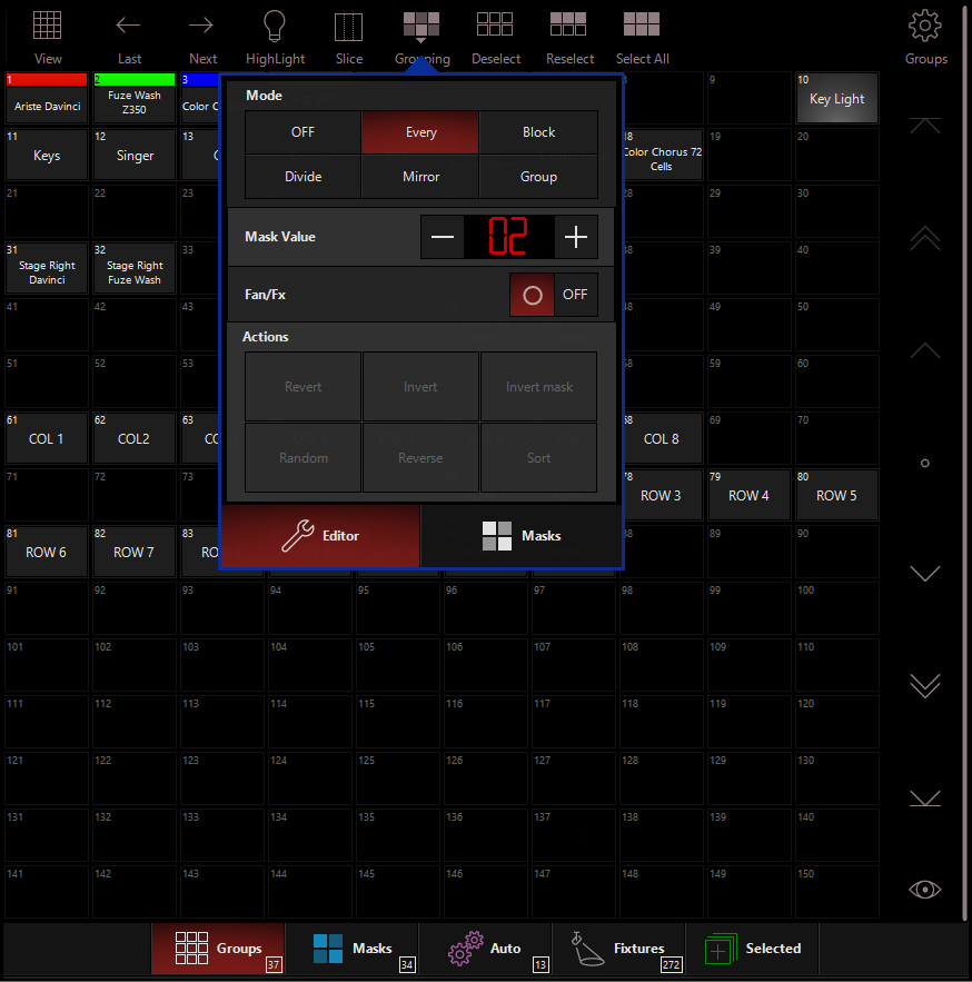

While the Command Line will by default receive all keyboard and keypad input, you may also use the keyboard to enter data into different windows on screen by activating that window.
For example, I have launched the Grouping Tools pop-up from the Groups window:
I now have used the right arrow key to select the "Every" filter, and I can type using the keypad to enter a "Mask Value". The focus of the keyboard stays on this pop-up until I close the pop-up.
