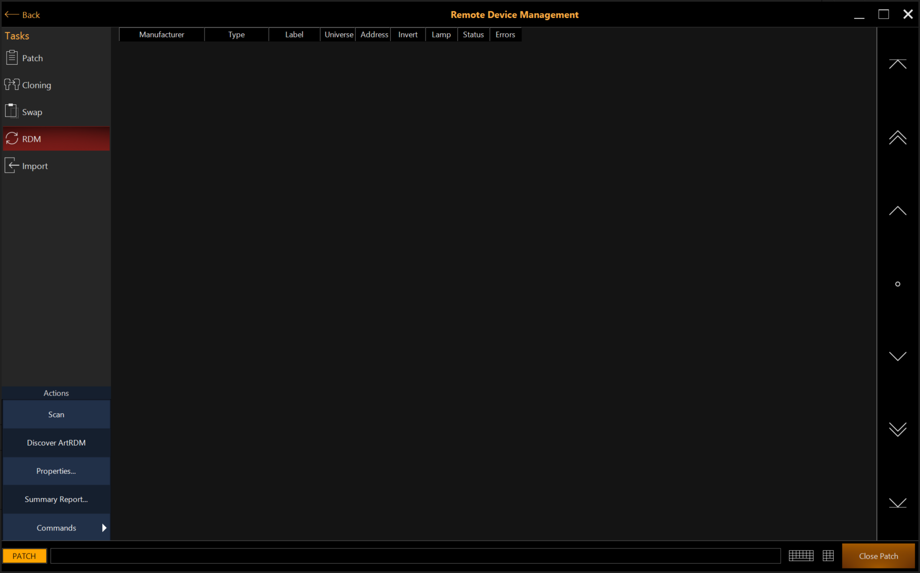

ONYX has a dedicated RDM tab in the patch to facilitate RDM data retrieval and commands at any time.
To view information for attached fixtures:
  1. Access the Patch by pressing ONYX in the upper left hand corner and pressing Patch.
  2. In Patch, navigate to the RDM tab on the left navigation.
  3. In the Actions section, at the bottom left of the screen hit Scan
The DMX outputs will be scanned to find any connected fixtures supporting RDM. The screen will be populated with any fixtures the console found.
