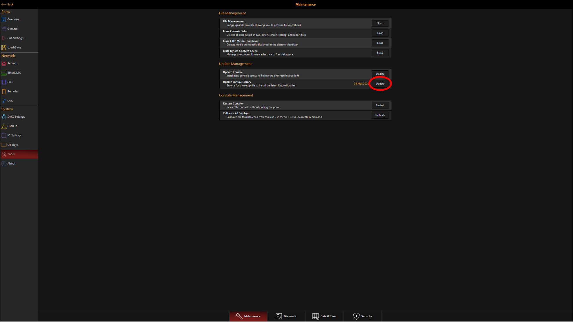

- From the Menu on the left select Tools
- Select Update next to "Update Fixture Library."
- If on a console, select the Fixture Library File from the USB thumb drive and press , or if on a PC, choose Library Fixture File from the downloads folder.
- Onyx will now update Fixture Library.
