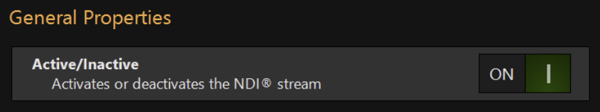

| Option | Description |
Sets if an NDI Stream should be received or ignored. *Enabling an NDI stream consumes considerable resources (CPU and network). It is good practice to disable unused streams. |
