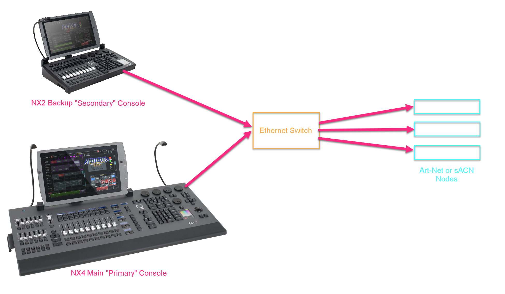

DMX output is not switched between the Primary and Secondary console, if a live switch is required due to a problem with the Primary Console then swapping the DMX Cables and Art-Net output from the Primary to the Secondary is required. Both Primary and Secondary console need to have the same amount of licenses available at all times otherwise full DMX output will not be possible.
If the DMX output is purely via Art-Net or sACN, connect both output devices to a network switch and disable Art-Net/sACN output on the Secondary console (otherwise there will be a conflict).
If a live switch is needed, simply turn the Art-Net/sACN output of the Primary off and turn the Art-Net/sACN of the Secondary console on, and you can continue to run the show from where the Primary console left off. Art-Net ON/OFF toggle is assignable to a Function Key. See the Sidebar and Function Keys section for more information.

Here is a simple diagram that demonstrates a simple Primary/Secondary console setup (Press to enlarge):
