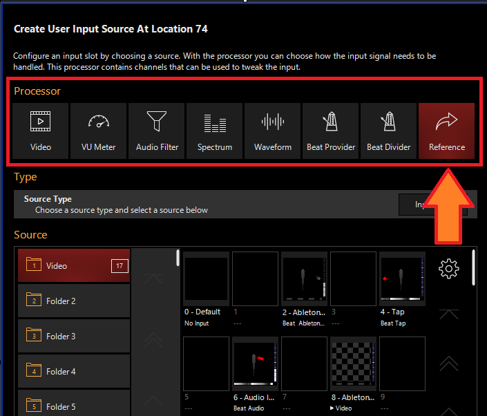

- Navigate to the Library view, button 5, on the default sidebar of the "Compose" workspace.
- Select the Tab at the bottom of the window:
- All slots will be blank if you're starting from scratch. To create one, Right-click or hold and press an empty slot.
- Select
- Select under Processor.
- Select the desired Source Type
- Select a source.
- Press
