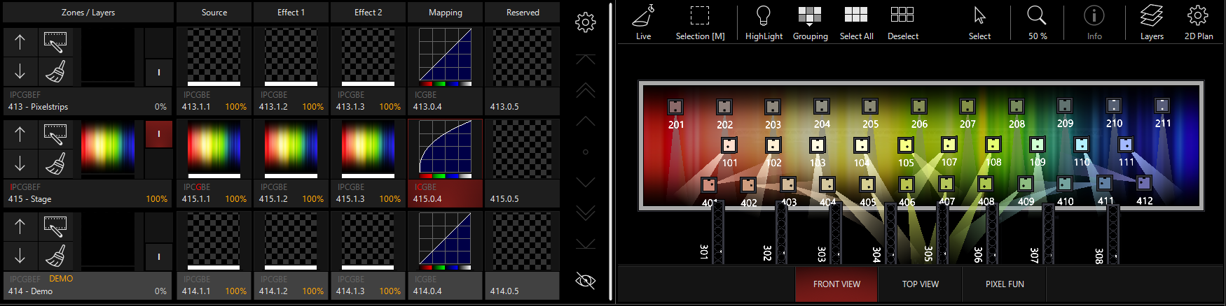

In the examples following, I'll use this image to illustrate because it has many colors, pastels, and black color values:
When we bring up the Brightness Subtract, we see the following result:
Then, we can switch to the Brightness Add mode by pressing the Icon near the bottom of the Zone Parameters or using the Encoders/Channel Visualization:

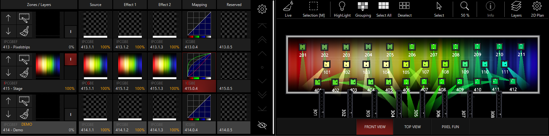

The Color parameters allow you to set adjustable Gamma for each color channel (red, green, blue, and white).
Gamma works by adjusting the color's response curve and can fix the problem of certain LED fixtures interpreting the colors too dark or too light.
If you adjust your Thumbnail mode to turn "Curve Mode" to "Show", you can see the gamma response on a graph.
In this example, we turn up the White gamma, which adjusts all 3 RGB Gamma Curves:
And then turn it down:
Then, the individual colors can be adjusted based off the location of the white curve:
Lower gamma values tend to make darker areas of the image look brighter. Higher gamma values takes the edge off the brightest parts of the image, but can make darker details get lost into black. Ultimately, the control is there to help make the DyLOS pixel mapping translate best to many types of fixtures.
