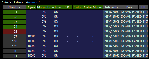

Example: To clear the “Cyan” attribute from only the first 5 Artiste DaVinci Profiles, we would use the following keystrokes:
- Select fixtures by pressing 101 THRU 105 ENTER
- Select the Color parameter group via the physical buttons or on-screen popup.
- Press and hold the button.
- Press the encoder button, or on-screen encoder (in the lower right hand corner)
The Programmer screen will then look like this:
You can see that the cyan attribute on the first 5 Artiste DaVinci Profiles is now set to null. This is sometimes referred to as “knocking out.”
