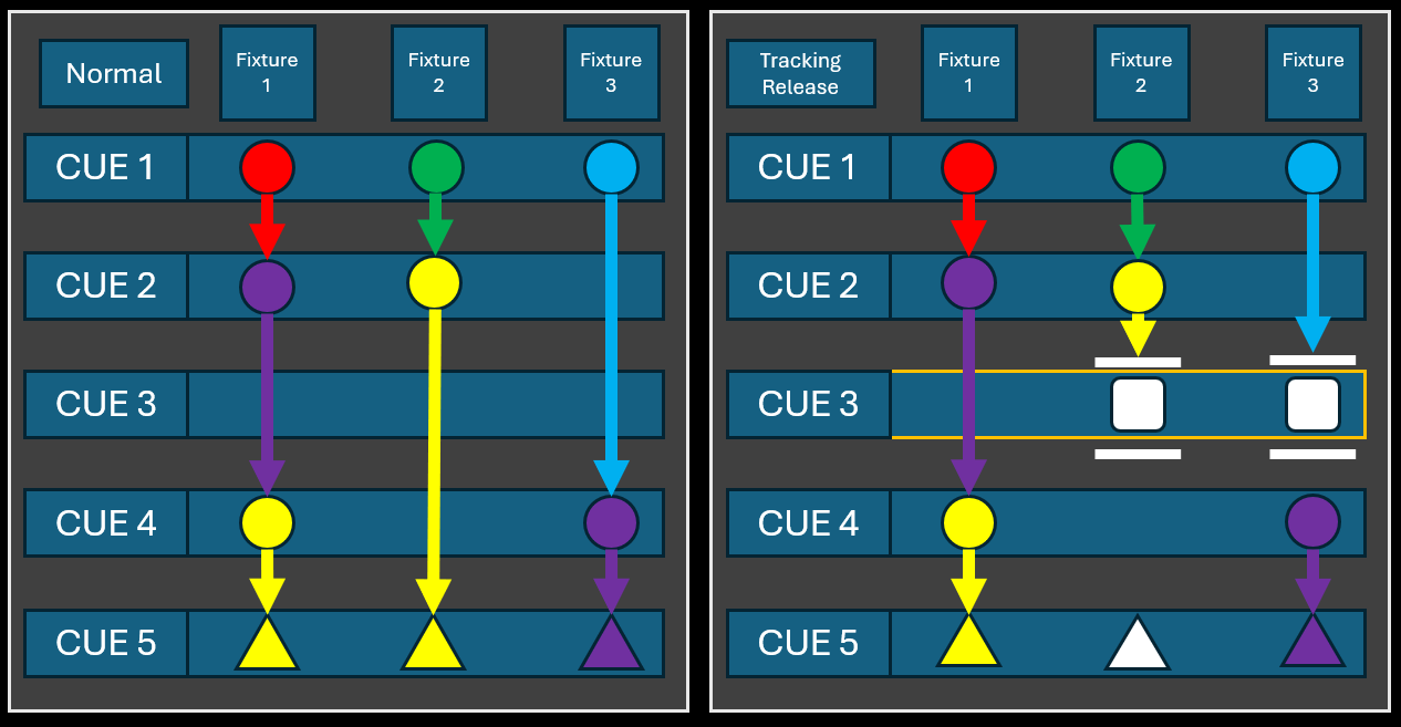

In the example below are 2 cuelists with the same data recorded in each cue.
The list on the left illustrates standard tracking, where each fixture's values persist (or 'track') through subsequent cues until explicitly changed. Each circle represents a value, with its color corresponding to the fixture's value. Cue 5 does not have any new data recorded, so it displays the last known values, which were carried forward from the previous cues.
The list on the right shows fixture 2 and 3 with a [RELEASE] (shown as a square for the example) value recorded onto its color parameters in cue 3 (outlined in orange for the example). This will block the tracking of these parameters and set fixture 2 and 3 to their default values.
Standard Tracking |
Tracking Release |

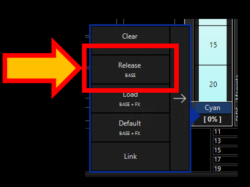

Setting a parameter to Release

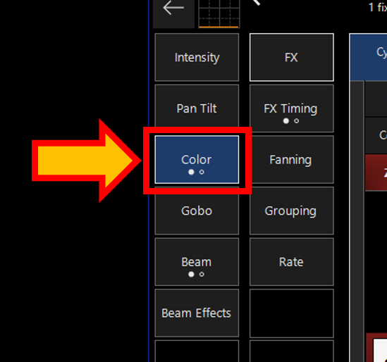

1) Select the fixture that you want to apply the release on.

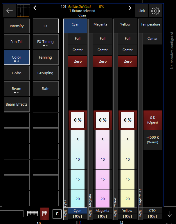

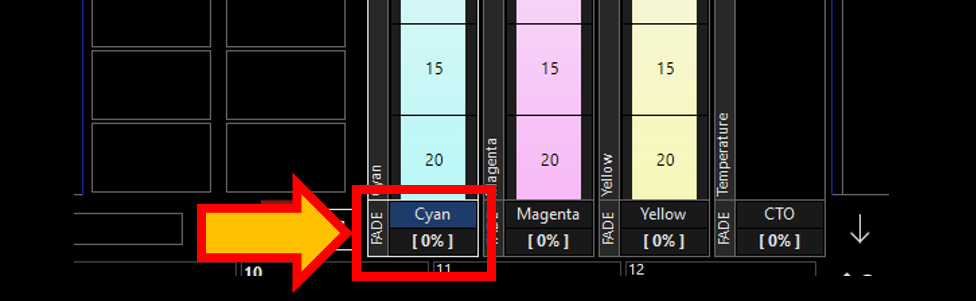

2) Press and hold on the parameter or right click on the parameter you want to apply the release on.
3) Select from the pop up menu

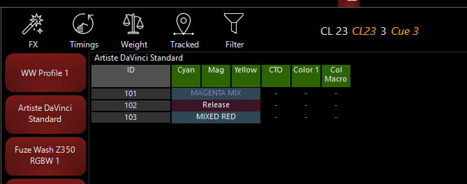

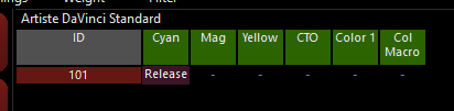

4) The programmer and CV will now show the value as [RELEASE]
5) Using the button add the [RELEASE] value into a new cue or Merge it into an existing cue.

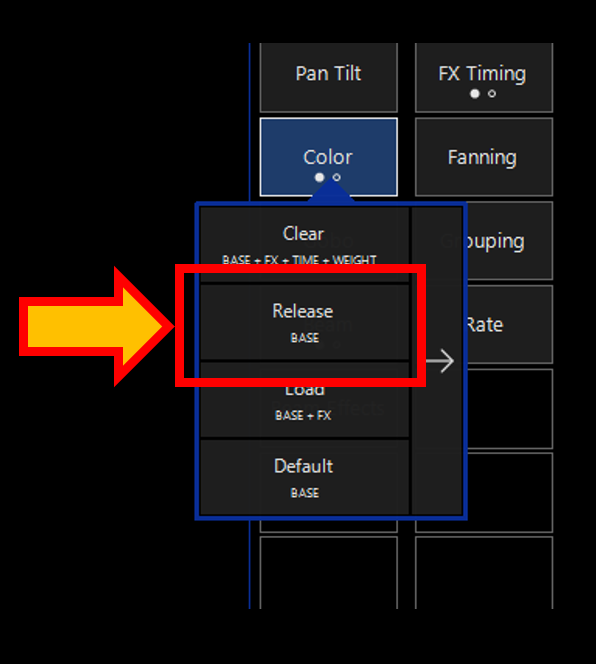

Setting a Parameter Group to Release
2) Press and hold on the parameter group or right click on the parameter group you want to apply the release on.
