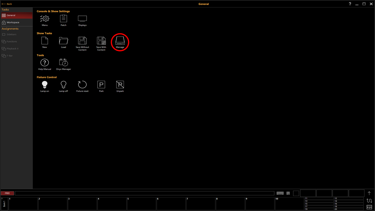

- Press the key on the console or the ONYX logo in the upper left corner of the screen.
- Press
- Select from the list on the left.

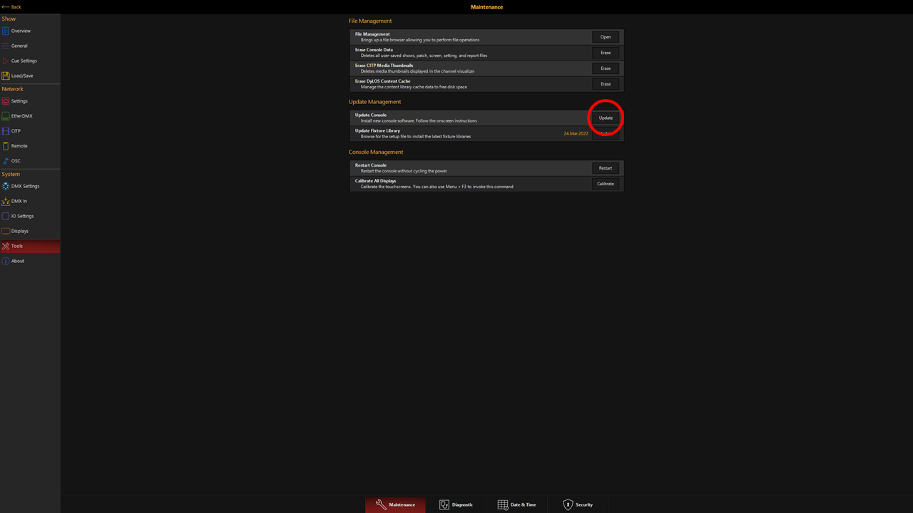

- Press

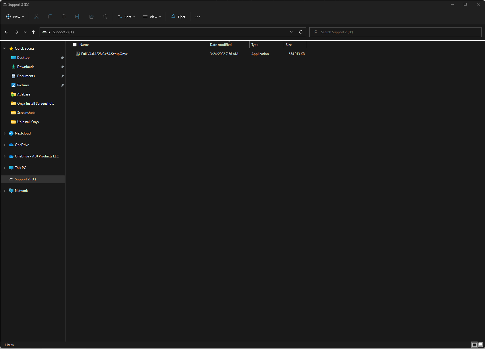

- Select the USB thumb drive from the list on the left and select the installer.
- Press, and follow the onscreen instructions.
