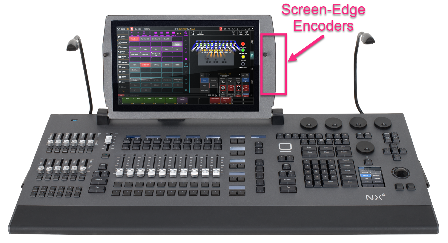

NX4 Encoder Assignment
The encoders on the screen edge of the NX4 are user assignable to any parameter currently available on the encoders:
To edit one of the screen-edge encoders:
- Hold the Key.
- Press down on one of the screen-edge encoders, or touch the legend next to it.
- The following window will open on the screen nearest to the encoder touched.
- Choose a parameter or group of parameters (I.E. Color, Gobo, Beam etc) to map to the encoder.
- Once the parameter is chosen, simply touch anywhere outside the box to hide it.
Note: Double clicking on the encoder will open the parameter popup just like the normal encoders.
Note: The FX, Fanning and Rate parameters can also be assigned to encoders, this enables super fast access to those parameters in a live programming or busking scenario.
