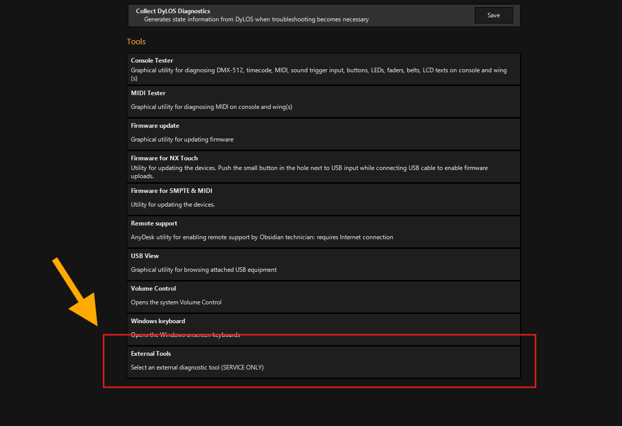

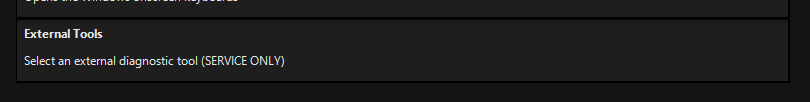

3. Navigate to MENU > TOOLS > DIAGNOSTIC > EXTERNAL TOOLS
4. Open the External Tools option and select the BIOS update file from the USB drive.

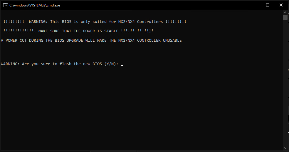

Press Y followed by Enter to select the BIOS upgrade.

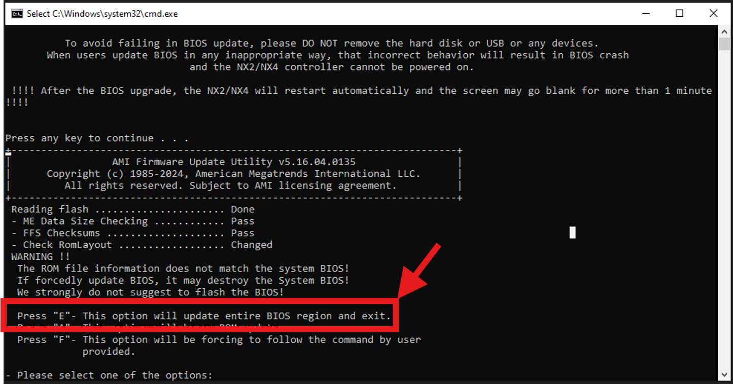

Press Enter
On NX2/NX4, select option "E"
The console will start the update process (DO NOT TURN THE CONSOLE OFF) until instructed to do so.
