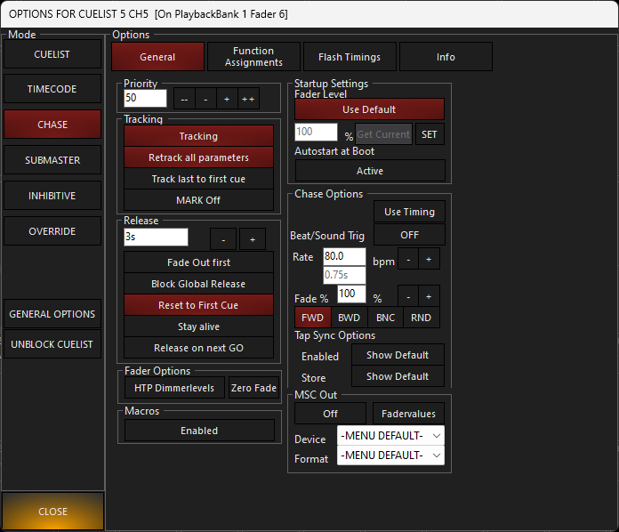

To set a cuelist to chase, select the cuelist and press the button in the upper-left hand corner of the Selected Cuelist window. When the Cuelist Options window opens, press the button found at the left-hand side of the screen.
When the Chase mode is selected a new box “Chase Options” is opened in the lower right hand corner of the options window. From here you can set the beats-per-minute rate of cue execution and the fade percentage, amongst other things.

While the Fade% and BPM settings can be changed “live” using the Live Time playback controls, in the case of the Fade%, it is suggested that the setting be changed in the Cue Options window as it is much more accurate.
You can now run the chase by closing the “Cue Options” pop-up and pressing the go button on the appropriate playback fader.
