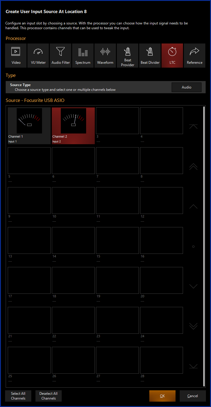

  1. Navigate to the Library view, button 5, on the default sidebar of the "Compose" workspace.
  2. Select the Input Source Tab at the bottom of the window:
  3. All slots will be blank if you're starting from scratch. To create one, Right-click or hold EDIT and press an empty slot.
  4. Select Create Input Source...

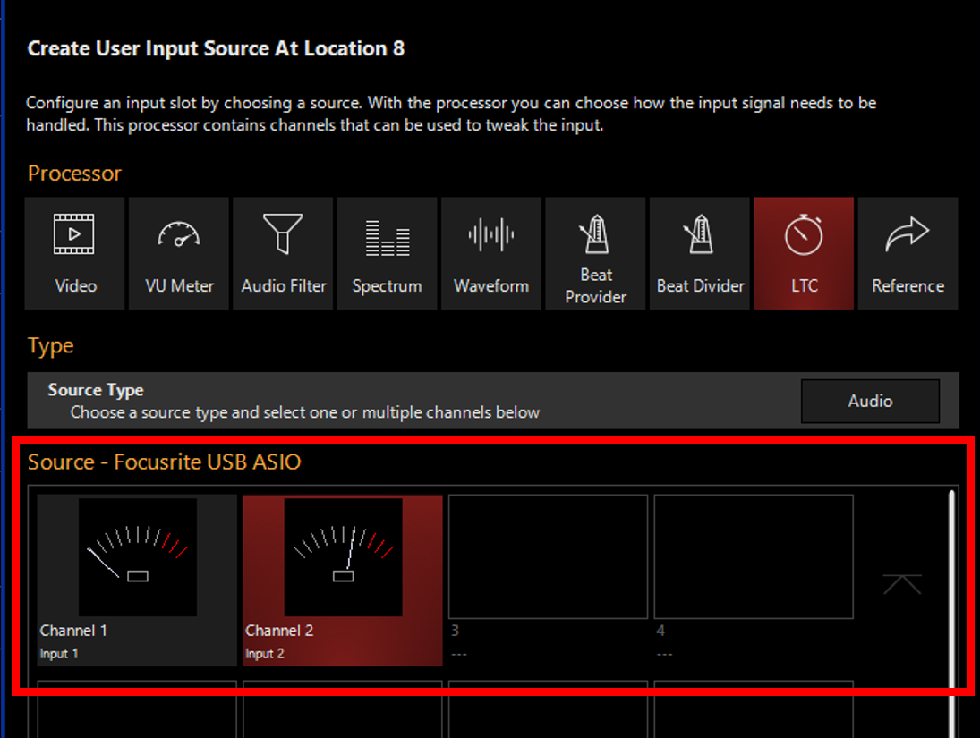

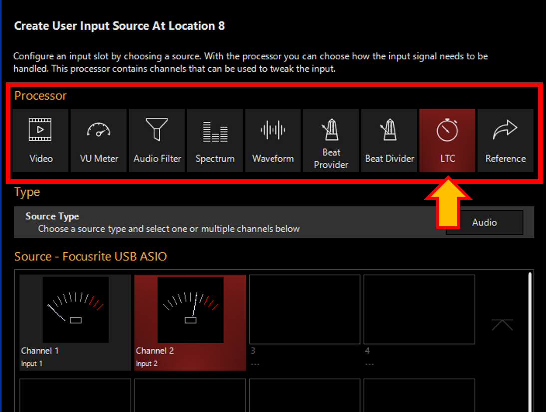

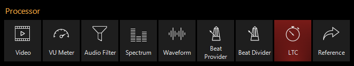

  5.  Select LTC under Processor.

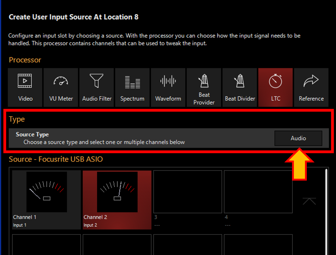

  6. Select the "Audio" Source Type
  7. Select the input channel that the LTC timecode is being sent to.
  8. Press OK

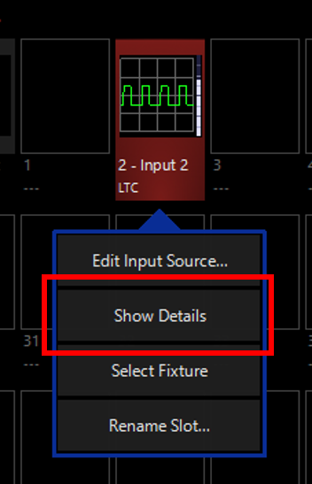

Editing a LTC Input Processor
  1. To edit a LTC Input Processor, press the Details button in the upper left corner or right-click on or hold Edit and select an existing LTC Input Processor.
  2. Select Show Details

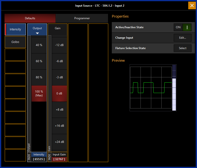

  3. From the menu below, you can change the properties of the LTC Input Processor.
Table of Controls
Control Description

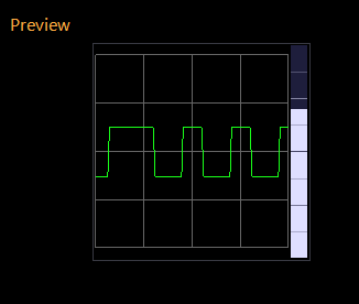

Preview
  1. Visualizer: Shows a visual representation of the input processor.
  2. Input Meter: Shows audio level of the incoming signal

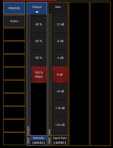

Intensity
Output: Sets the Output level of the LTC Input Processor
Input Gain: Sets the Gain level of Audio input of the LTC Input Processor

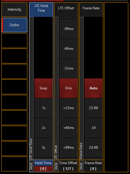

Gobo
LTC Hold Time: Sets how long the LTC clock will continue after losing the signal.
LTC Offset: Sets the amount of offset (positive and negative) from the received input time.
Frame Rate: Sets the frame rate of the incoming input;
  • Auto (Default, will automatically detect the framerate.)
  • 23.98
  • 24
  • 24.98
  • 25
  • 23.97 NDF (No Drop Frame)
  • 29.97 DF (Drop Frame)
  • 30
  • 50
  • 59.94 NDF (No Drop Frame)
  • 59.94 DF (Drop Frame)
  • 60
  • 1000
