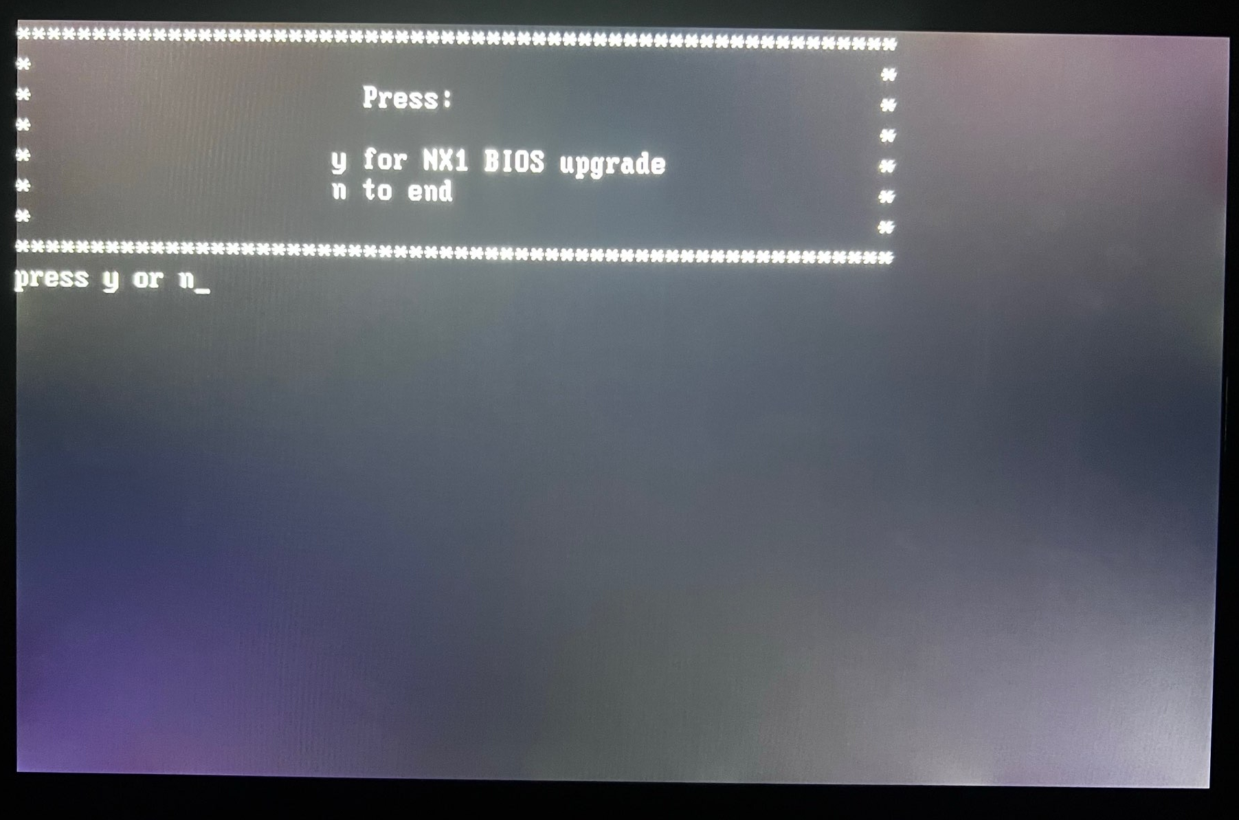

The console will show this screen after booting from the BIOS Update USB drive.
Press followed by to select the BIOS upgrade.

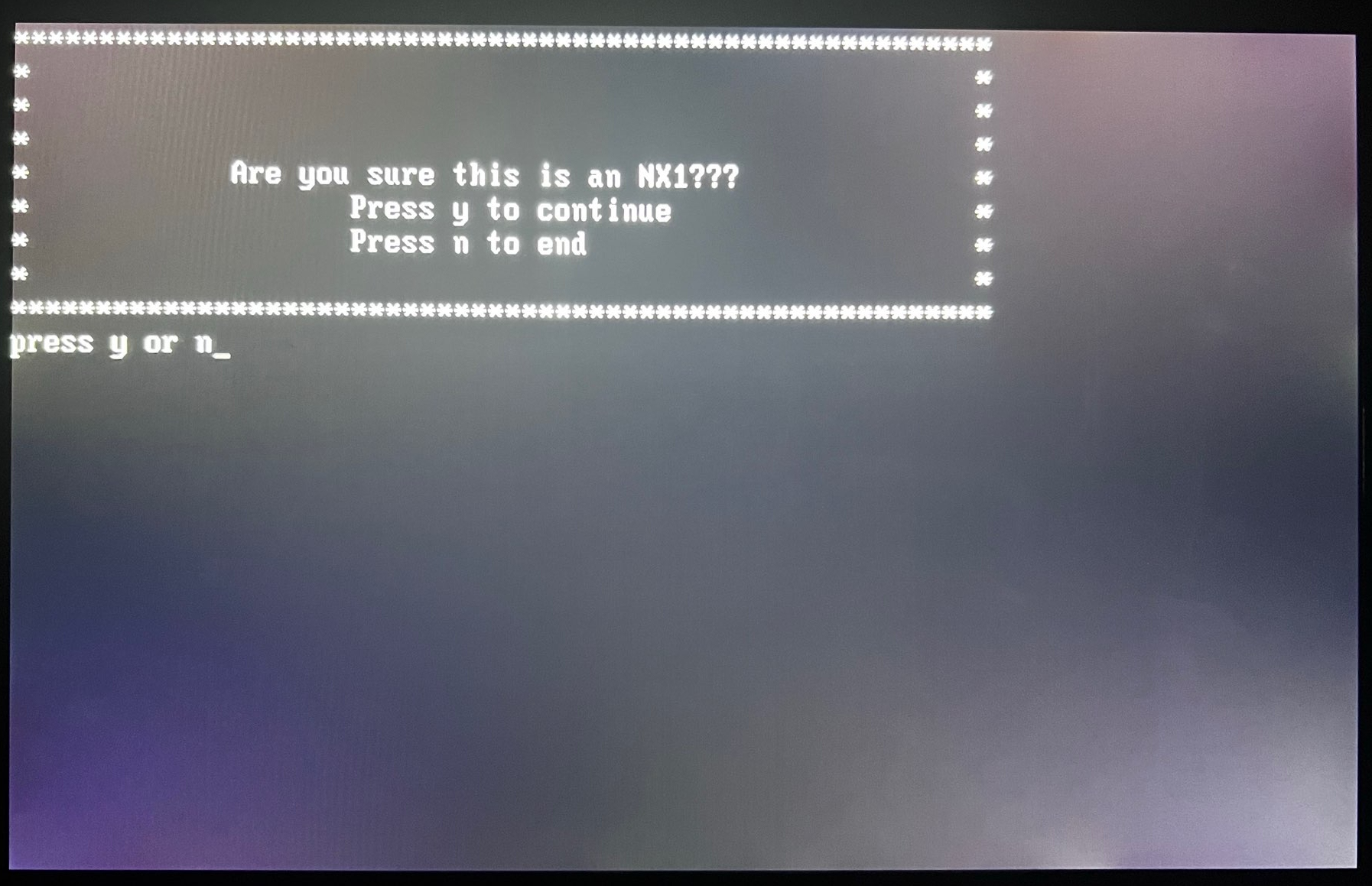

Press
Press followed by to start the Update, the console will start the update process (DO NOT TURN THE CONSOLE OFF)
