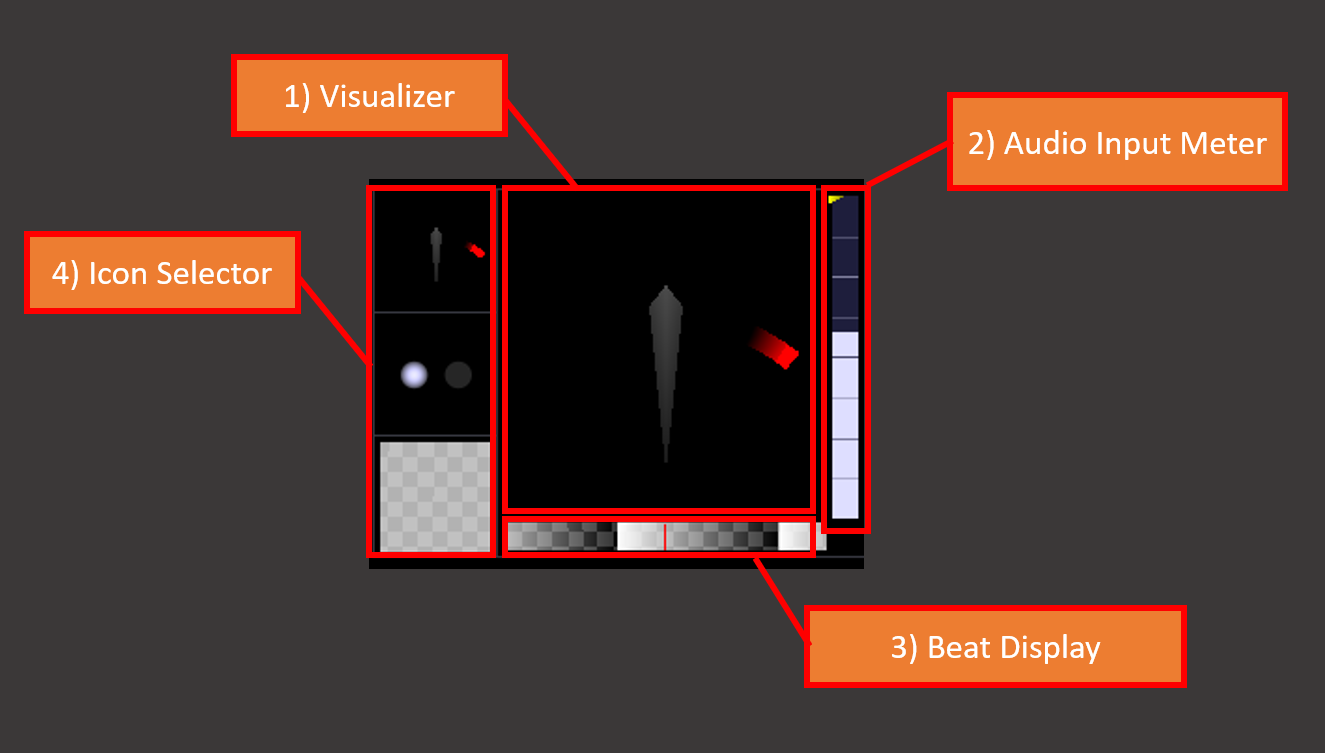

Preview
PropertiesActive/Inactive State: Toggles the state of the Input between Active and Inactive. * The “Inactive” state helps preserve resources on an overloaded system.* Show in Toolbar: Adds the Input processor the to tool bar at the top of the display. Advanced Analyzer: Enables/Disables the Advaned Analyzer view. Change Input: Used to select a different source input for this Input. Fixture Selection State: Select the Input as a fixture for making changes using the Channel visualizer (CV) Beats Per Minute: Shows the current detected or operating BPM Ableton Links: Shows the number of active Ableton Links |
