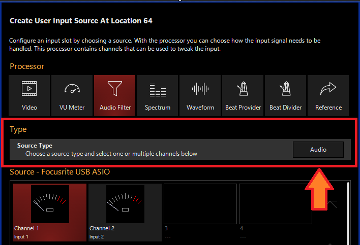

- Navigate to the Library view, button 5, on the default sidebar of the "Compose" workspace.
- Select the Tab at the bottom of the window:

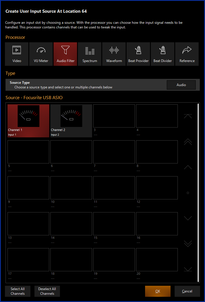

- All slots will be blank if you're starting from scratch. To create one, Right-click or hold and press an empty slot.

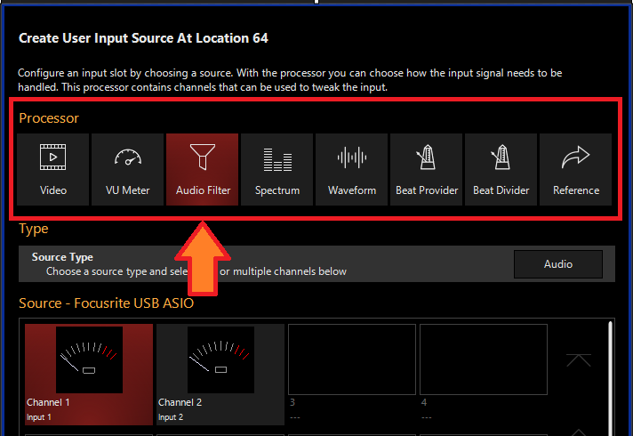

- Select

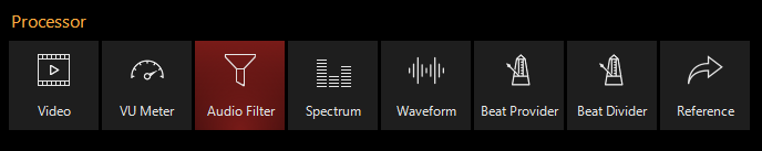

- Select under Processor.

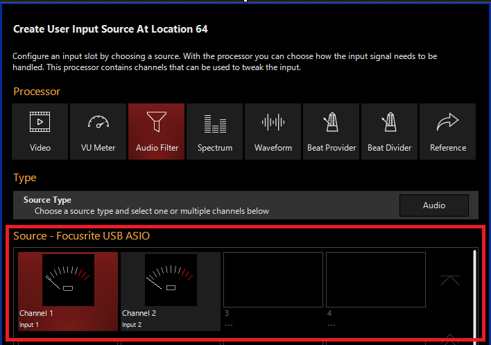

- Select the desired Source Type
- Select the Source
- Press

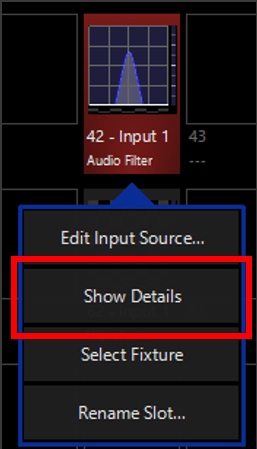

- To edit a Audio Filter Input Processor, right-click on or hold and select an existing Audio Filter Input Processor.
Select

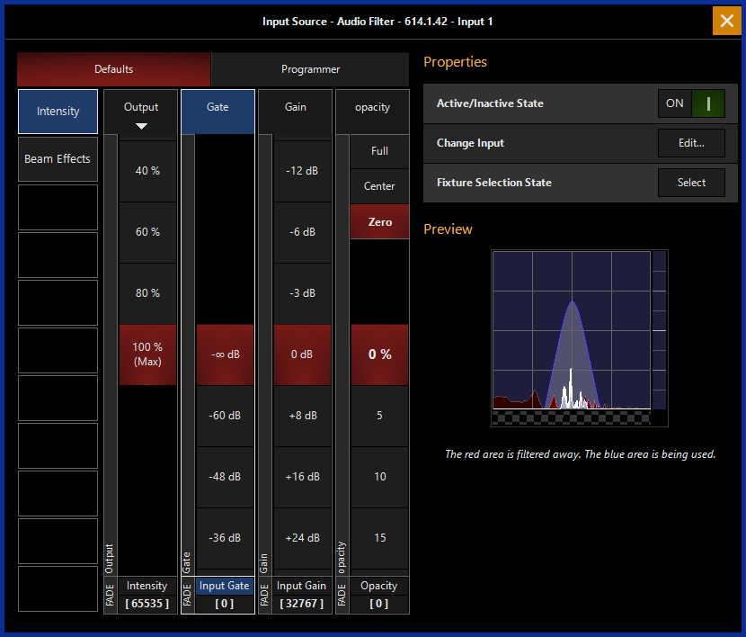

From the menu below, you can change the properties of the Audio Filter Input Processor.
Table of Controls
| Control | Description | ||||||||||||||

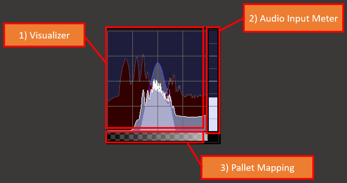

Preview
PropertiesActive/Inactive State: Toggles the state of the Audio Filter Input Processor between Active and Inactive. * The “Inactive” state helps preserve resources on an overloaded system.* Change Input: Used to select a different source input for this Audio Filter Input Processor. Fixture Selection State: Select the Audio Filter Input Processor as a fixture for making changes using the Channel visualizer (CV) |
This Selects if the changes should be made to the default properties of the Audio Filter Input Processor or put into the programmer like if editing a fixture. Used for changing the default state of this Audio Filter Input Processor Used for temporary changes recorded into a cue. |
Output: Sets the Output level of the Audio Filter Input Processor *A value of zero translates to an output of transparent black.
Input Gate: Sets an Audio Input Gate on the incoming audio level of Audio Filter Input Processor Input Gain: Sets the Gain level of Audio input of the Audio Filter Input Processor
Opacity Level: Sets the Opacity level of the Audio Filter Input Processor for when used as Media Content.

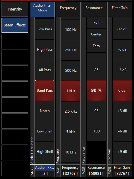

Beam EffectsAudio Filter Mode: Sets the Filter shape.
Frequency: Sets the frequency to be filtered. Resonance: Sets the frequency filter width. Filter Gain: Sets the gain level of the filtered range. |
