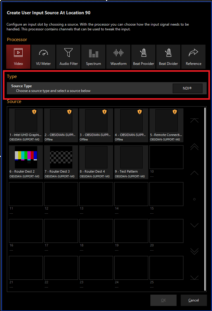

Input Source Types
Input Source Types indicate the type of external source input for the input processor.
Source Type Description

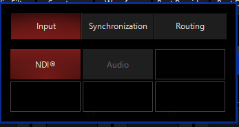

Input
NDI: NDI inputs can include Video or Audio Information
Audio: External Audio Input

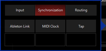

Synchronization
Ableton Link: Ableton Link allows for synchronizing tempo, beat, and phase from Ableton Live and Ableton Link-enabled applications via a network connection.
MIDI Clock: The MIDI-Start message sets the 1 beat. If there is no Start message, the first beat coming in gets the 1 assigned. Users can override the 1 in the same way as in the audio detection mode.
Tap: Detects used input BPM from an assignable tap sync button.

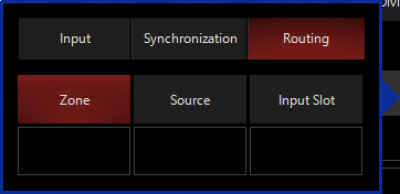

Routing
Zone: Selects a Dylos Zone as the input for a video processor.
Source:  Selects the Source Block of a Dylos Zone as the input of a video processor.
Input Slot: Selects another Input Processor for connecting multiple input processors.
